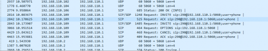

Have you programmed the first BLF to the ring group / queue / user?
Make a pcap from the "Call" and check it please.
Hello Marc,
i have programmed the first BLF to ring a user directly. I have created a pcap file, see the attached picture. This is unfortunately anything what he captured from this source (192.168.110.109 , our Fanvil i18s)2022-06-03 13_37_48-dump.pcap.png
Currently the old Fanvil i10 is connected and works perfect, just the sound qualitiy is not so good. But it's more than nothing.
