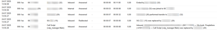

Hallo zusammen
Bei einem Kunden habe ich unerklärliche Anrufabbrüche. Gemäss Anrufprotokoll zeigt es mir den Anruf als beendet an.
Der Kunde bekommt nicht mit, dass der Anruf abgebrochen ist.
Im Aktiväten-Protokoll sehe ich auch nichts Spezielles:
24.07.2025 14:07:36.483    Currently active calls [none]
24.07.2025 14:07:06.480    Currently active calls - 1: [428]
24.07.2025 14:06:36.476    Currently active calls - 1: [428]
24.07.2025 14:06:06.473    Currently active calls - 1: [428]
alle 30 Sekunden der gleiche Eintrag
24.07.2025 13:57:36.413    Currently active calls - 1: [428]
24.07.2025 13:57:06.409    Currently active calls - 1: [428]
24.07.2025 13:56:36.405    Currently active calls - 1: [428]
24.07.2025 13:56:08.003    C:428 Transfer Leg: L:429.3[Extn:32{00000000-01db-fc91-ea0f-195200000741}] connects to L:428.1[Line:10001<<0617179888{00000000-01db-fc91-d825-c3290000073a}] replacing L:428.5[Extn:20{00000000-01db-fc91-d8f9-46000000073e}]
24.07.2025 13:56:08.002    C:428 attended transfer replaces L:429.1[Extn:20{00000000-01db-fc91-ea0f-193700000740}]
24.07.2025 13:56:06.401    Currently active calls - 2: [428,429]
24.07.2025 13:55:59.581    Call(C:429): == Connected L:429.1[Extn:20{00000000-01db-fc91-ea0f-193700000740}] and L:429.3[Extn:32{00000000-01db-fc91-ea0f-195200000741}]
24.07.2025 13:55:56.490    C:429: calling from L:429.1[Extn:20{00000000-01db-fc91-ea0f-193700000740}] to Extn:32{00000000-01db-fc91-ea0f-195200000741}
24.07.2025 13:55:56.490    C:429 + Call started +
24.07.2025 13:55:36.397    Currently active calls - 1: [428]
24.07.2025 13:55:35.249    Call(C:428): == Connected L:428.1[Line:10001<<06xxxx{00000000-01db-fc91-d825-c3290000073a}] and L:428.5[Extn:20{00000000-01db-fc91-d8f9-46000000073e}]
24.07.2025 13:55:27.753    C:428 Referred leg : L:428.1[Line:10001<<06xxxx{00000000-01db-fc91-d825-c3290000073a}]
24.07.2025 13:55:27.752    C:428 Transfer request from L:428.3[Route:voip_manager.Main@{}{00000000-01db-fc91-d831-94c10000073c}] by Route:voip_manager.Main@{}{00000000-01db-fc91-d831-94c10000073c}
24.07.2025 13:55:26.657    Call(C:428): == Connected L:428.1[Line:10001<<06xxxx{00000000-01db-fc91-d825-c3290000073a}] and L:428.3[Route:voip_manager.Main@{}{00000000-01db-fc91-d831-94c10000073c}]
24.07.2025 13:55:26.442    C:428: calling from L:428.1[Line:10001<<06xxxx{00000000-01db-fc91-d825-c3290000073a}] to Route:ROUTER@{10001}10001{00000000-01db-fc91-d825-c3510000073b}
24.07.2025 13:55:26.442    C:428 + Call started +
24.07.2025 13:55:26.437    Line limit check: Current # of calls for line Lc:10001(@Peoplefone[<sip:[email protected]:0/UDP>]) is 1; limit is 10
24.07.2025 13:55:26.436    [CM503012]: Inbound office hours rule (HN) for 10001 forwards to DN:voip_manager.Main
24.07.2025 13:55:26.436    [Flow] Looking for inbound target: called=+416xxxx; caller="xxxx" <sip:06xxxx@:0>
Anrufprotokoll:
Wo muss ich weitersuchen?
LG Alain

Der Anruf von 07:58 Uhr wurde abgebrochen und Anruf von 08:00 Uhr ging ohne Probleme.
Da die Abbrüche nicht regelmässig sind, konnte ich bis jetzt kein Wireshark erstellen.
Sieht man hier einen möglichen Fehler?
