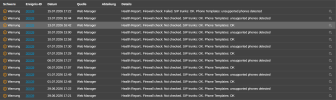

Since updating to the latest 3CX version, the built-in 3CX Health Check now seems to run periodically on its own. Every time it runs, our Snom phones get unregistered for about a minute, and one of our SIP trunks goes red (unregistered) for roughly the same period. Both recover on their own afterwards, but during that minute calls are obviously affected.
The Health Report in the logs shows:
  • Firewall check: Failed
  • SIP trunks: OK
  • Phone Templates: unsupported phones detected
