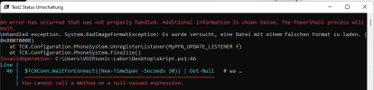

Habe zum Testen dein Schnipsel (https://www.3cx.de/forum/threads/geschäftszeiten-anhand-eines-kalenders-steuern.114149/post-401462) im Notepad++ als ".ps1" gespeichert und die Nebenstelle und die Zwei Parameter für Windows angepasst. Das Schnipsel sieht bei mir jetzt so aus:
$tcxappname="StatusUmschaltung"     # script name, must be unique at runtime
$extnumber="35"                    # customize: extension number for status change
# $startday=10;               # adjust to start duty on the right day
# $cycledays=1;              # duty cycle days
# if( [int]((Get-Date).Ticks/10000000/86400 + $startday) % $cycledays -eq 0 ) {
#     Write-Host "duty on"    # and change status ...
# } else {
#     Write-Host "duty off"   # and change status ...
$osname=[System.Environment]::OSVersion.Platform
if( $osname -match "win" ) {
    $tcxdllfilelocation="C:\Program files\3CX Phone System\Bin\3cxpscomcpp2.dll"
    $tcxinifilelocation="C:\Program Files\3CX Phone System\Bin\3CXPhoneSystem.ini"
} else {
    $tcxdllfilelocation="/usr/lib/3cxpbx/3cxpscomcpp2.dll"
    $tcxinifilelocation="/var/lib/3cxpbx/Bin/3CXPhoneSystem.ini"
Add-Type -Path $tcxdllfilelocation "C:\Program Files\3CX Phone System\Bin\3cxpscomcpp2.dll" # Debian "/usr/lib/3cxpbx/3cxpscomcpp2.dll", Windows "C:\Program files\3CX Phone System\Bin\3cxpscomcpp2.dll"
Function ReadConfiguration() {
    $CurrentSectionName=$null
    foreach($striline in ([System.IO.File]::ReadLines($tcxinifilelocation).Trim())) { "C:\Program Files\3CX Phone System\Bin\3CXPhoneSystem.ini" # Debian "/var/lib/3cxpbx/Bin/3CXPhoneSystem.ini", Windows "C:\Program Files\3CX Phone System\Bin\3CXPhoneSystem.ini"
        $delim="[","]"
        if ($striline.StartsWith("[")) {
            if( $CurrentSectionName -notmatch "ConfService" ) {
                $CurrentSectionName = ($striline -Split {$delim -contains $_}).Where({$_ -ne "" })
            } else {
                break
        elseif( ($CurrentSectionName -ne $null) -and (-not ([string]::IsNullOrEmpty($striline))) -and (-not ($striline.StartsWith("#"))) -and (-not ($striline.StartsWith(";")))) {
            if( $CurrentSectionName -match "ConfService" ) {
                $param=$striline.split("=")[0].Trim()
                $value=$striline.split("=")[1].Trim()
                switch( $param ) {
                    "confNIC"  { $PS::CfgServerHost=$value }
                    "ConfPort" { $PS::CfgServerPort=$value }
                    "confUser" { $PS::CfgServerUser=$value }
                    "confPass" { $PS::CfgServerPassword=$value }
$PS = [TCX.Configuration.PhoneSystem]
ReadConfiguration
$PS::ApplicationName = $tcxappname
$TCXConn = ($PS::Root)
$TCXConn.WaitForConnect((New-TimeSpan -Seconds 30)) | Out-Null   # wait for connection to 3CX
if( $TCXConn.Connected ) {

Ich habe jetzt PowerShell Version 7 installiert (zuvor war es V5 - Standard Windows 11). Bin über die Microsoft Seite auf github gelandet und hab dort die aktuellste Version 7.3.2 installiert.
Nun habe ich jetzt nochmals dein Schnipsel 1:1 kopiert und nur die Nebenstelle von 211 auf 35 geändert, sonst nichts.
Der Fehler jetzt:
Kann leider nur einen Screenshot posten, da das Fenster gleich wieder zu geht, trotz -noexit in der Verknüpfung, die jetzt so aussieht unter Eigenschaften -> Ziel: C:\Program Files (x86)\PowerShell\7\pwsh.exe -ExecutionPolicy bypass -Command "& C:\Users\VOIPsonic-Labor\Desktop\skript.ps1"
Das Fenster geht gleich wieder zu, da in Command ein & davor steht ;)
