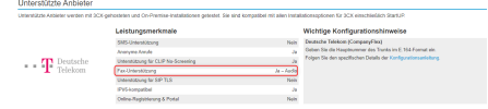

Grandstream per SBC angebunden, Provider Deutsche Telekom (CompanyFlex - Cloud)
FAX Transmission Mode: FAX in T.38 (was gem. Telekom funktionieren muss)
