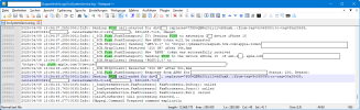

Hier nochmal ganz frisch und Hohe Protokollierung vom IPhone aktiv:
2025/04/09 14:39:25.377|0023|Info| Sending PUSH call-started for dn=21, replaces=RejPkd2IYJbO3zoBxGb-0g..;from-tag=d379155d;to-tag=1847fd1a, callerid=+XXXXX, callername=XXX:test, Id=37.239, image=
2025/04/09 14:39:25.377|0023|Info| [_3CX.Push.PushTransport] IV: Sending PUSH to extension 21 device iPhone 13 mini
2025/04/09 14:39:25.377|0023|Info| [_3CX.Push.PushTransport] New APNS token will be requested
2025/04/09 14:39:25.377|0023|Info| [_3CX.HttpClient] Sending 'GET/2.0' to 'https://pbxservicespush.3cx.com/apple-token?facilityId=THZO0-NSF39-XXXX-XXXX-NE7UE'
2025/04/09 14:39:25.722|0044|Info| [_3CX.HttpClient] Received '200 OK' after 344.8ms
2025/04/09 14:39:25.732|0044|Info| [_3CX.Push.PushTransport] Sending PUSH to the device iPhone 13 mini  of ext.21. apns-id=74b53f3c-3f36-44fe-a4d8-2363653c632f
2025/04/09 14:39:25.732|0044|Info| [_3CX.HttpClient] Sending 'POST/2.0' to 'https://api.push.apple.com/3/device/a11d03735cc4d3d65ea7b6f35d2fae1d47cedb793f2cca9ce5f1be6482a2aaf1'
2025/04/09 14:39:25.733|0023|Debg| Dequeue Updated.PARAMETER.963
2025/04/09 14:39:25.733|0023|Debg| Dequeue Deleted.TRANSACTION.94
2025/04/09 14:39:26.158|0044|Info| [_3CX.HttpClient] Received '200 OK' after 425.6ms
2025/04/09 14:39:26.158|0044|Info| [_3CX.Push.PushTransport] Response from APNS for 74b53f3c-3f36-44fe-a4d8-2363653c632f: Status: 200, Reason:
2025/04/09 14:39:46.311|0049|Info| Sending PUSH call-ended for dn=21, replaces=RejPkd2IYJbO3zoBxGb-0g..;from-tag=d379155d;to-tag=1847fd1a, callerid=+49511923590, callername=Phoneas:test, Id=37.239
