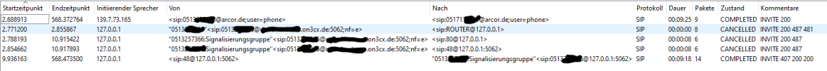

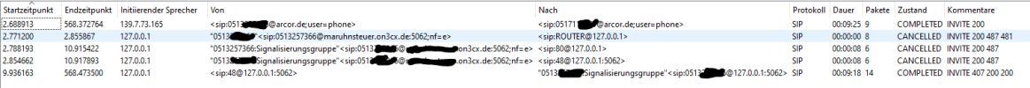

Im Bereich des SIP Checker abe ich einen ausgehende Anruf auf diese Nummer anschließend generiert:
Kann der Sipcode durch die Fritzbox erzeugt werden? Wenn ich mein Handy anrufe ist alles ok

UTC Arrival Time: Aug 20, 2026 09:06:46.279645000 UTC
Epoch Arrival Time: 1787216806.279645000
[Time shift for this packet: 0.000000000 seconds]
[Time delta from previous captured frame: 25.846000 milliseconds]
[Time delta from previous displayed frame: 25.846000 milliseconds]
[Time since reference or first frame: 29.103132000 seconds]
Frame Number: 5976
Frame Length: 953 bytes (7624 bits)
Capture Length: 953 bytes (7624 bits)
[Frame is marked: False]
[Frame is ignored: False]
[Protocols in frame: sll:ethertype:ip:udp:sip:sdp]
Character encoding: ASCII (0)
[Coloring Rule Name: UDP]
[Coloring Rule String: udp]
Linux cooked capture v2
Protocol: IPv4 (0x0800)
Reserved: 0000
Interface index: 1
Link-layer address type: Loopback (772)
Packet type: Unicast to us (0)
Link-layer address length: 6
Source: 00:00:00_00:00:00 (00:00:00:00:00:00)
Unused: 0000
Internet Protocol Version 4, Src: 127.0.0.1, Dst: 127.0.0.1
0100 .... = Version: 4
.... 0101 = Header Length: 20 bytes (5)
Differentiated Services Field: 0x00 (DSCP: CS0, ECN: Not-ECT)
0000 00.. = Differentiated Services Codepoint: Default (0)
.... ..00 = Explicit Congestion Notification: Not ECN-Capable Transport (0)
Total Length: 933
Identification: 0xca6d (51821)
010. .... = Flags: 0x2, Don't fragment
0... .... = Reserved bit: Not set
.1.. .... = Don't fragment: Set
..0. .... = More fragments: Not set
...0 0000 0000 0000 = Fragment Offset: 0
Time to Live: 64
Protocol: UDP (17)
Header Checksum: 0x6ed8 [validation disabled]
[Header checksum status: Unverified]
Source Address: 127.0.0.1
Destination Address: 127.0.0.1
[Stream index: 1]
User Datagram Protocol, Src Port: 5062, Dst Port: 5483
Source Port: 5062
Destination Port: 5483
Length: 913
Checksum: 0x01a5 [unverified]
[Checksum Status: Unverified]
[Stream index: 18]
[Stream Packet Number: 14]
[Timestamps]
[Time since first frame: 26.768021000 seconds]
[Time since previous frame: 9.913352000 seconds]
UDP payload (905 bytes)
Session Initiation Protocol (INVITE)
Request-Line: INVITE sip:[email protected]:5483 SIP/2.0
Method: INVITE
Request-URI: sip:[email protected]:5483
Request-URI User Part: EndCall
Request-URI Host Part: 127.0.0.1
Request-URI Host Port: 5483
[Resent Packet: False]
Message Header
Via: SIP/2.0/UDP 127.0.0.1:5062;branch=z9hG4bK-524287-1---a5e73d7447fb1179;rport
Transport: UDP
Sent-by Address: 127.0.0.1
Sent-by port: 5062
Branch: z9hG4bK-524287-1---a5e73d7447fb1179
RPort: rport
Max-Forwards: 70
Contact: <sip:[email protected]:5062>
Contact URI: sip:[email protected]:5062
Contact URI User Part: 49
Contact URI Host Part: 127.0.0.1
Contact URI Host Port: 5062
To: <sip:[email protected]:5062>
SIP to address: sip:[email protected]:5062
SIP to address User Part: 01726XXX
SIP to address Host Part: 127.0.0.1
SIP to address Host Port: 5062
From: " Josef"<sip:[email protected]>;tag=65d35425
SIP from display info: ", Josef"
SIP from address: sip:[email protected]
SIP from address User Part: 49
SIP from address Host Part: 127.0.0.1
SIP from tag: 65d35425
Call-ID: hJFM4L5ypHY7uAS6aInZOQ..
[Generated Call-ID: hJFM4L5ypHY7uAS6aInZOQ..]
CSeq: 1 INVITE
Sequence Number: 1
Method: INVITE
Subject: p=#NOTFOUND
Allow: INVITE, ACK, CANCEL, OPTIONS, BYE, REGISTER, SUBSCRIBE, NOTIFY, REFER, INFO, MESSAGE, UPDATE
Content-Type: application/sdp
Supported: replaces, timer
Content-Length: 379
Message Body
Session Description Protocol
Session Description Protocol Version (v): 0
Owner/Creator, Session Id (o): 3cxPS 29756508333932544 19664081841553409 IN IP4 127.0.0.1
Owner Username: 3cxPS
Session ID: 29756508333932544
Session Version: 19664081841553409
Owner Network Type: IN
Owner Address Type: IP4
Owner Address: 127.0.0.1
Session Name (s): 3cxPS Audio call
Connection Information (c): IN IP4 127.0.0.1
Connection Network Type: IN
Connection Address Type: IP4
Connection Address: 127.0.0.1
Time Description, active time (t): 0 0
Session Start Time: 0
Session Stop Time: 0
Media Description, name and address (m): audio 8522 RTP/AVP 0 8 9 109 101
Media Type: audio
Media Port: 8522
Media Protocol: RTP/AVP
Media Format: ITU-T G.711 PCMU
Media Format: ITU-T G.711 PCMA
Media Format: ITU-T G.722
Media Format: DynamicRTP-Type-109
Media Format: DynamicRTP-Type-101
Media Attribute (a): rtpmap:0 PCMU/8000
Media Attribute Fieldname: rtpmap
Media Format: 0
MIME Type: PCMU
Sample Rate: 8000
Media Attribute (a): rtpmap:8 PCMA/8000
Media Format: 8
MIME Type: PCMA
Sample Rate: 8000
Media Attribute (a): rtpmap:9 G722/8000/1
Media Format: 9
MIME Type: G722
Sample Rate: 8000 (RTP clock rate is 8kHz, actual sampling rate is 16kHz)
Audio Channels: 1
Media Attribute (a): rtpmap:109 opus/48000/2
Media Format: 109
MIME Type: opus
Sample Rate: 48000
Audio Channels: 2
Media Attribute (a): fmtp:109 maxplaybackrate=48000;stereo=1;useinbandfec=1
Media Attribute Fieldname: fmtp
Media Format: 109 [opus]
Media format specific parameters: maxplaybackrate=48000
Media format specific parameters: stereo=1
Media format specific parameters: useinbandfec=1
Media Attribute (a): rtpmap:101 telephone-event/8000
Media Format: 101
MIME Type: telephone-event
Sample Rate: 8000
Media Attribute (a): fmtp:101 0-15
Media Format: 101 [telephone-event]
Media format specific parameters: 0-15
Media Attribute (a): ptime:20
Media Attribute Fieldname: ptime
Media Attribute Value: 20
Media Attribute (a): sendrecv
Habe zu spät gesehen das ich auch eine CSV exportieren kann.
